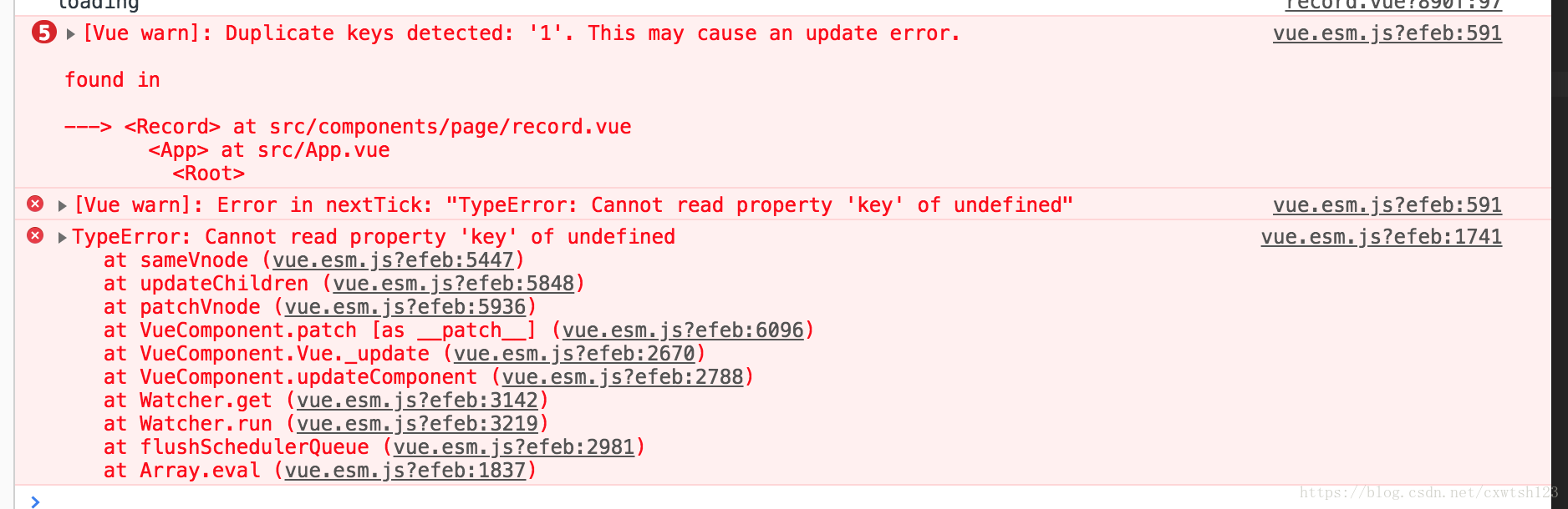

Duplicate keys detected: "'. This may cause an update error. vue报错

1.报错信息
错误信息展示为关键字‘keys‘,此时应该检查for循环中的key,循环的key值不为唯一性
van-cell
v-for
"(item,index) in list"
:key
"item"
pw_item
van-cell
1
2
3
此时应将item改为index,则不再报错了:
<van-cell v-for="(item,index) in list" :key="item">
pw_item
</van-cell>
